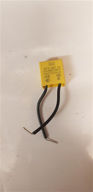

I have recently installed a smart light switch that works with alexa and needs no neutral at the switch.
To enable it to function correctly they provide a capacitor that has to be connected across the live and neutral at the ceiling rose.
My question is.. Are these regarded as being safe?
Thanks for any help
Dave
  • That mostly depends on what sort of capacitor.  A suitably rated Class Y capacitor should be safe enough if installed properly.  They are designed to fail open circuit if overloaded (e.g. by a voltage surge).

  • That looks like a Class X2 capacitor.  It's rated for mains voltage, but could go "pop" in the event of a fault.  If it is the one supplied, I wouldn't worry about it.

    Ok thanks Simon.
  • Agree class X. Perfectly safe to be connected between L and N, on any circuit with suitable ADS (like a fuse or breaker, which I'm sure your lights do have) Failure will not endanger human life, just put the lights off.
    If a failure would endanger life such as between live and a otherwise isolated  metal part you might touch,  then a tighter standard applies. (class Y)
