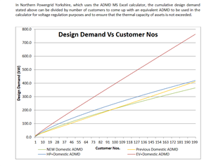

    Surprise yourself with the ADMD figures in this PDF from UKPN  see  table 8-1 page 19
    The data in pages 44-45  of this report on designing future proof LV networks  from northern powergrid is probably more realistic than national grid, in showing a near doubling of demand above the old ADMD curves if an electric vehicle is added.
    Note how under the current LV network, (yellow curve) 100  users can be fed by a 250KVA transformer with a bit in hand. With EV in use (upper red, not so curved  curve) something nearer a 400kVA transformer is needed for the same no of households. The table below is the granular data to be used for when a very small no of houses share a transformer/ street cable, and a smooth curve is not applicable. I assume Yorkshire is not densely populated enough to warrant calculating the curve up to transformers of the 1MVA level just yet ?

    I'm somewhat puzzled by that data and the graph.  Assume everybody gives up their gas heating and petrol cars.  On a winter's day, everybody will plug in their EVs, but only a handful of people will turn on their heat pumps?
  • Its not my data,  just some stuff in my pile of interesting and possibly useful reading material, but I think their assumption is that the heat pumps will only be on in winter, and flicking on and off by thermostat, so not steady state. There is a reasonably good understanding of domestic heating requirements from the historical use of economy 7 storage heating, and there are modified  ADMD figures factor that in, and they are not that much more onerous than the baseline figures - houses really do settle down to a couple of kW on average even with storage heaters, presumably as they too turn off  once heated. Also perhaps a heat pump house is supposed to be better insulated than normal one ?
