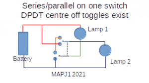

Thought A was to switch them between normal parallel connection and series, with a switch and mainbeam driving a DPDT relay through diode OR logic. However, it gives no real design choice of how dim - probably too dim, 6V may not be enough to operate (or reliably). And it seems the automotive industry doesn't offer DPDT relays in “outdoor” packaging with spade terminals (only SPDT).
