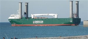

    Nuclear ships is the obvious answer.
  • now you mention it something like that has been done. But squares are not always the best shape unless you want to run from the wind.
    Ah yes, that's probably what you are thinking of.

    I think if you want to reduce fuel consumption on ships it can be done by utilising wind power. There is, after all, a correlation between the height of the waves and the power of the wind. If we were to fit tall masts on the ships with horizontal bars and hang large squares of canvas to be driven by the wind, this might work…….
