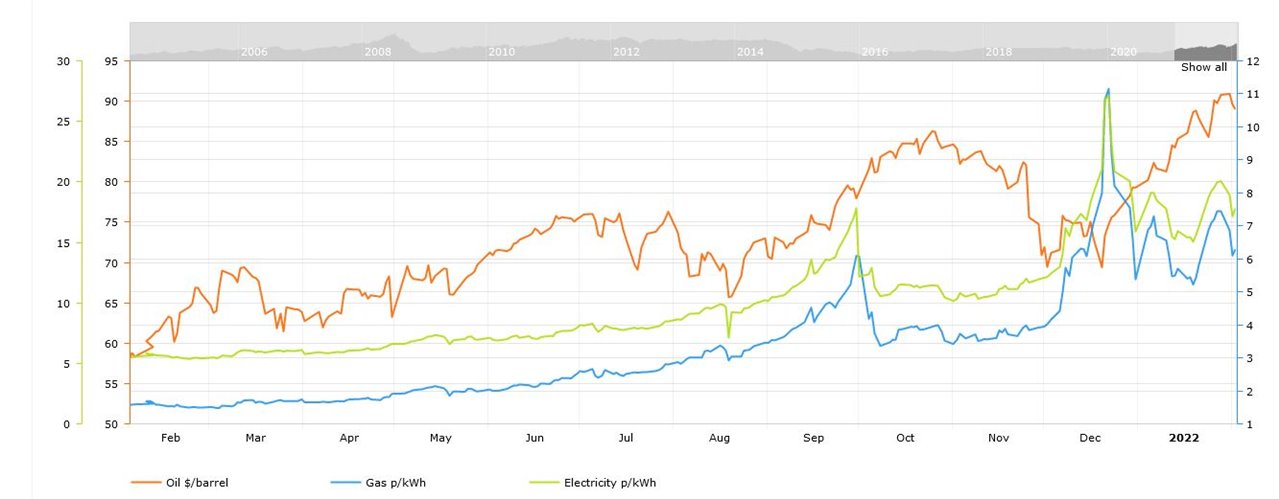

Looking at the wholesale prices the suppliers pay shows not much for them to live off. (from this website)
Beware the 3 sets of funny axes, orange for oil in dollars per 200 liter barrel, and gas and electricity in UK pence per kWhr
Last year at this time the cap prices were 2/3 of their April values approx, but the wholesale costs were about half. It seems far from clear to me that even the now reduced set of suppliers will all survive another year if trends continue.
