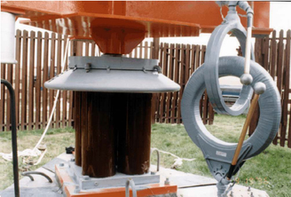

  • As a bit of a sidetrack there are places that really do need transformers with core, primary and secondary windings really well insulated from each other but they are only seen in the world of pulse power or high RF , and those customers do not worry about magnetic losses, or indeed safety of personnel, to the same degree (no one is there when it is fired up, and even if they are, they are certainly not there to comment after it has fired ..)
    Pulse power.
    (Tall thin core about the size of a stocky door frame.)
    That cone shaped secondary has earth at the bottom, and so can be near the core, and winds up to a classified no of kV at the top, hence the greater spacing. Note also the top rolled edges to reduce discharges, and the inter-winding structures to 'grade' the field . It would normally sit in oil .
    RF isolation
    ('Austin rings') low frequency AC for aircraft warning lights etc.
    Here the air gapped loops are a transformer, the lower one  iron cored and wound toroidally in the normal way and the upper loop is the secondary, wound hula hoop-like on an insulating former.
    These are used to get a 'mains' supply onto a tower that is a vertical antenna, but also happens to be driven with a few KV p-p of RF at the base insulator...
    Neither approach is remotely  practical compared to  a conventional transformer or simply  an RCD and a gap..
    Mike
