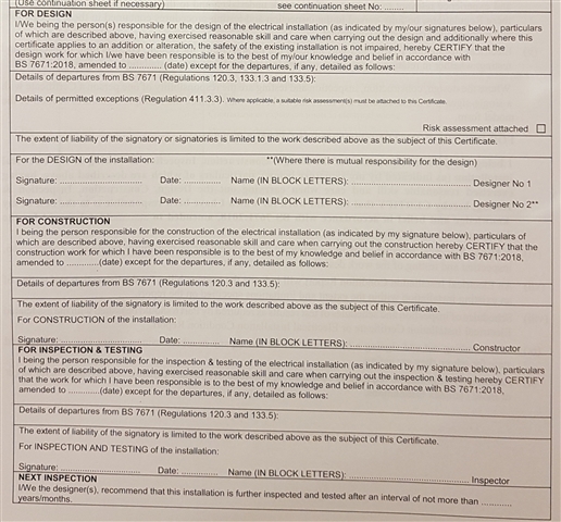

  • The one week level 4 City and Guilds is intended for qualified electricians who have been working and training for at least three years, so they have three years experience along with a level 2 and 3 in electrical installation plus a level 3 qualification in inspecting and testing along with a level 3 qualification to demonstrate an understanding of current edition of the wiring regulations.
    If your degree educated engineers don’t have the inspecting and testing qualification they will have to do this as part of the course to get the C&G 3696.
    The Design, Erection and Verification course covers all the requirements to sign the Electrical Installation Certificate for each of those .
    So, are your engineers capable of signing to say the have checked and approved the design, they have checked and approved the installation work, as well as testing and verifying the installation to say it is safe to energise and use?
    What testing qualifications and experience do they have to verify the installation work?
  • How many boxes on an Electrical Installation Certificate do your engineers sign, how many can they sign?
