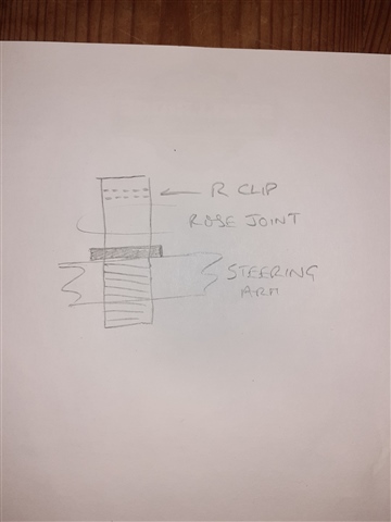

  • Thank you for your replies. So, are you saying Mike that I could, in effect, bolt a stud into the steering arm with a nut top and bottom so that it is rigid, immobile and then secure the rose joint with, maybe, an R clip?
    If so, what I really want is some sort of stud that is smooth, hardened at one end and M12 threaded on the other.

  • No, but you could have an over-sized stepped bolt inserted from below.
    Sorry, I forgot, you don't have a lathe. Wink
    Forget nuts top and bottom and R-clips. The inner part of the rose joint needs to be firmly clamped to the steering arm in such a way that nothing will come loose.

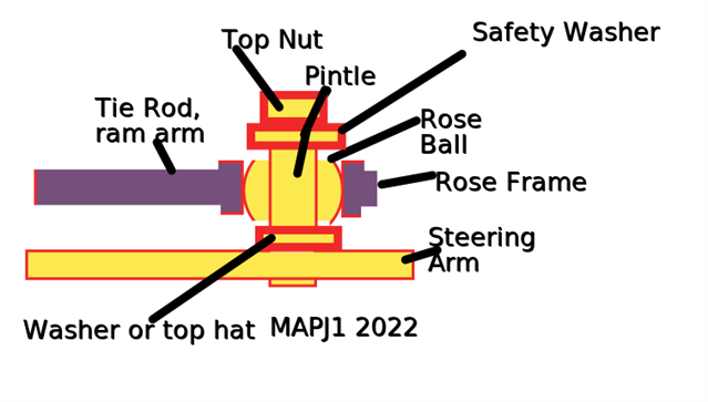

  • Sorry Chris, I don't quite understand what you're saying. Can't insert a stepped bolt from below as the steering tie rod is in the way. I thought I had it clear in my head but surely the rose joint should be "floating"
  • The ball of the 'rose' joint is the only moving part, and it moves within the body of the rose joint. The pintle should not rotate within the ball nor within the steering arm (hence my comment about tack welds in the field.).
    This is surprisingly hard to explain in words. Sketch coming, but not quickly.
    EDIT sketch 1, the naming of the beast. lower washer or top hat sets rose ball height and means ram arm comes in level and un-strained.  safety washer ensures steering action not totally lost if ball ever pops from frame. All yellow parts move as one. Unless ram arm miles off parallel so optimum ball height varies during turn and then a rising pintle is needed.

  • Thank you very much Mike, your "sketch" is somewhat better than my pencil drawing on the back of an invoice! And I think I have finally got my thick head around it. I've ordered a new bush so I'll mic it up when it's been in the freezer and drill appropriately!

  • That is good,  - as we so often find on here the battle is getting 'the obvious' out of one head into another, and without a pic, and even sometimes with one,  it is easy to run off with the wrong end of the stick - I have lost count of the times I have commented with an answer to not quite right for the question that was actually intended.
    Be aware that mechanical language is a bit regional, so  my words and what folk call the bits may not match at your local motor factors or whatever.
    I should have said - if the motion of the ram end and the steering arm is not co-planar, (and if it isn't then the ram mechanism may jam), then the place to let it rise and fall is  on the pintle in the hole of the rose joint ball . If you do need that then that will need to be lubricated, as it will also tend to turn there as well as at the ball in the frame. Looking at your photos more closely, the hole in the rose joint ball does look like it may be lined - if that is an oiling bronze bush, then it is intended to allow that use, but of course not on a thread, but a smooth hardened surface.
