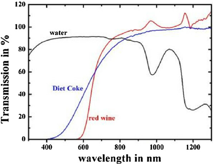

    Consider sensing with multiple wavelengths, as the optical performance of coloured or transparent objects are often very different in the infra-red. It always tickles me that red wine becomes almost clear at 850nm , a common TV remote control frequency.
    Mike.
