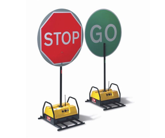

  • so, what happens at roadworks and so on when there is a need for single lane working ?
    Ours can be programmed to be 2 way or 3/ 4 way or remote controlled junction, and the older ones have a data cable between the units and newer ones use a UHF telemetry link at 400 and something MHz. These default to all red if the link between the sets   is jammed or fails for some reason, which is rare but very annoying as then one waits for ages and wonders if one should break the law and pass at red...
    The config is by text message or by plugging in controller that comes with the kit usually co-sited with a genset. The smaller radio ones have self contained batteries and need no cables.
    M
    PS some literature for folk using them with standard configurations etc.
    https://artsm.org.uk/media/ARTSM-Guidance-on-Use-of-Portable-Signals-1-1.pdf
