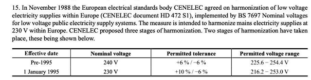

I appreciate within Appendix 2 the voltages tolerances are stated as
Is it possible to work out with these tolerances if the methodology behind compliance with 722.411.4.1 (V) is met?
