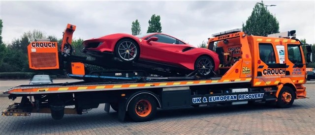

  • The flatbed truck with a built in crane is fine in the open but doesn’t work in multi-story car parks or similar as there is not enough headroom. I guess this prompted the development of the Multitract systems.
