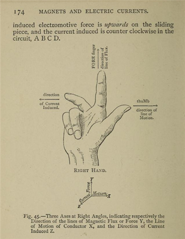

    The two flavours of the three finger mnemonic occasionally referred to  as the corkscrew rule, is usually associated with John Ambrose Fleming and his text book  ** (All together now "motors left and gener-righters".. )
    Faraday brought us experimental evidence of induction.

    Look up Wiki; who think Fleming but also mentions Ampere but I think it used to be Lenz corkscrew rule that was taught 60 years ago..
    Anyway, the important thing is to understand that all Radiant power is Electromagnetic and that the current induces a flux at right angles which rotates therefore producing a spinning area of magnoflux 2D inertia.  AC domestic power uses 50 cycles per second generators. But because of the corkscrew ruler we must synchronise the generators individually.  Applying a DC voltage at right angles then produces 3D power energy
    99.99% of our planets energy comes from our star the sun and all of it is the form of radiant energy; not conductive, convective or gravitational energy.
    Our planet is being kept warm by the massless spinning magnoflux2D inertia field that can travel through space without loss if attracted forward by a DC voltage, to be absorbed by matter as it has a voltage between its negative shell and inner protons to become 3D magnoflux heat energy keeping the planet warm.
  • Heinrich Lenz, in Annalen der Physik in 1834 - writing almost half a century before the time of Maxwell and Herz remember, and at a point when the concept of a  'field' was not really a thing used in the modern sense - wrote a short piece translating into german and then building on Faraday's work in the UK that was then itself pretty new.
    Lenz's essential addition was the observation that energy is conserved, so any currents induced are in the direction that create magnetic forces that oppose those that created it.
    (So sadly no perpetual motion machines with motors driving generators, the torque needed to spin the generator  takes the same energy as the electricity you generate plus a bit extra for  losses - plenty of folk on you tube don't seem to get that right even almost 100 years later.)
    In short that we put mechanical energy into a generator and get it out of a motor..
    The hand rules only work once you have an agreed  concept of directions of field lines in space, and that is probably mostly a Heavvside thing - as shown, the  likes of Faraday and Lenz were discussing current flow, forces and magnetic poles, without reference to fields, or for that matter electrons.

  • Thanks Mike,
    Yes, you are probably correct corkscrew rule came later
