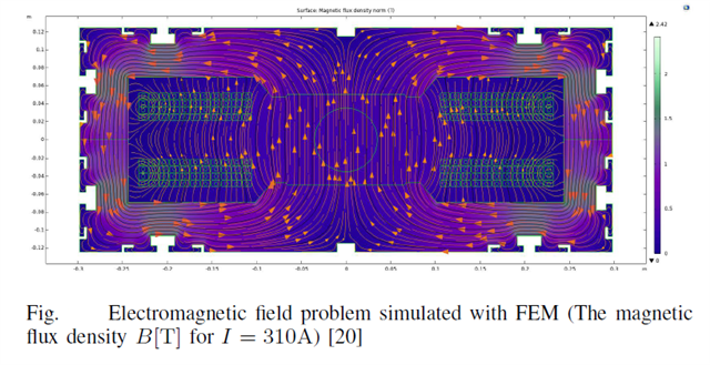

Numerical Modeling with COMSOL: Capturing Electromagnetic Behavior
COMSOL Multiphysics served as the simulation backbone, solving magnetostatic problems governed by Maxwell's equations:
∇⋅B=0,∇×H=J,B=μH

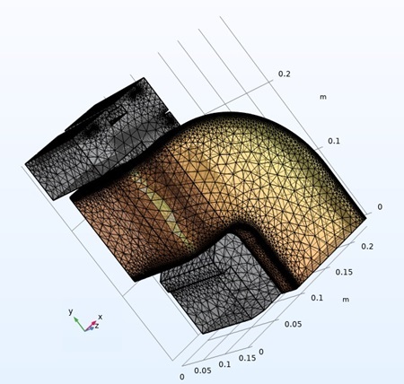

We modeled the magnet in both 2D and 3D, exploiting symmetry to reduce computational domains (e.g., quarter-section in 2D, eighth in 3D). The 2D model, with a mesh of ~268,000 triangular elements, was ideal for quick iterations on local properties like f1 and f4. For integral quantities (f2, f3), 3D models (~75,000 tetrahedral elements) captured end effects and fringe fields, using the magnetic vector potential formulation:
∇×(ν∇×A)=J

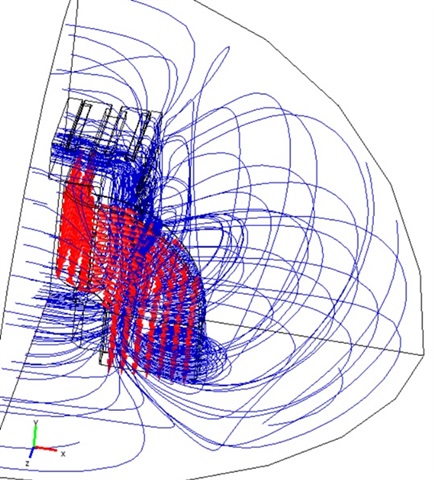

Boundary conditions included magnetic insulation on outer surfaces and symmetry constraints (Dirichlet on one axis, Neumann on another). Nonlinear material properties were incorporated via the B-H curve, and current densities were defined subdomain-wise (e.g., helical approximations in coils).
Simulations ran for excitation currents from ±15.5 A to ±310 A, revealing field distributions with peak densities near poles and uniformity in the good-field region. For instance, at 310 A, the central B-field matched measurements within 0.1%, highlighting COMSOL's accuracy in predicting saturation and flux leakage.

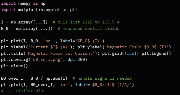

Local Excitation Curve Processing Script loads currents I and central fields B₀, computes normalized f₁ = B₀/I, and plots:
  • B₀ vs I (linear-ish with saturation at high |I|)
  • B₀/I vs I (shows permeability drop due to saturation)
Code example (simplified):
This revealed hysteresis minimal and saturation onset, with f₁ stable ~0.00109 T/A at low currents.

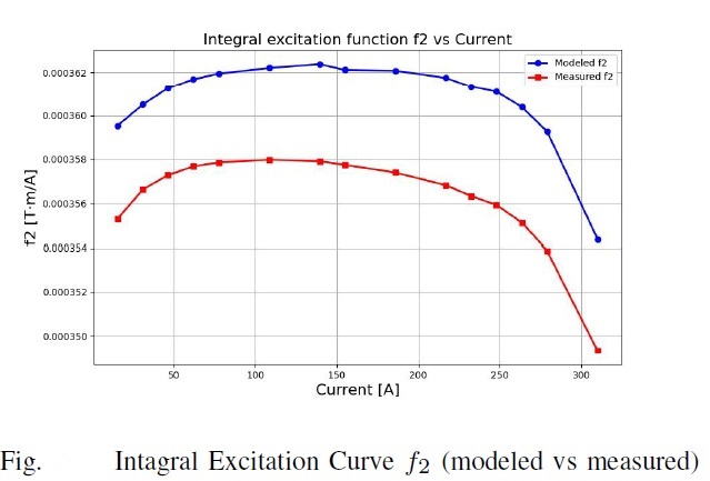

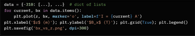

Integral Excitation Curve For longitudinal profiles, scripts plot B_x(z) for selected currents (symmetric positive/negative), then compute integrated BL/I separately for positive/negative ramps to check consistency.
  • Multi-line plot: B_x vs z for I = ±62, ±186, ±310 A shows good symmetry and end roll-off.
  • BL/I vs I plots: very flat (~0.000333–0.000335 Tm/A), confirming effective length near-constant.
Code snippet for multi-current plot:

  • Integral Excitation: Errors <1.5%, but Python highlighted larger discrepancies (~11%) at magnet ends, attributable to fringe effects—prompting model refinements.
