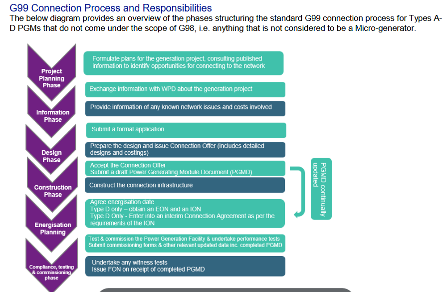

  • If you are (just) the installers do you even have access to all the design information you would need to submit it ?
    As if not the designer needs to provide that to the installer anyway, and if they are doing that they may as well send a copy to the DNO as any query that was not a trivial answer would get reflected back to them...
    I presume the problem, as always, is really one of un-budgeted extra costs and effort...
    How far is it down this process chart ?
    Dark green is DNO action, light green is customer or representatives..
    Mike.

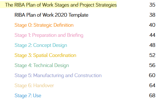

  • How far is it down this process chart ?
    What's really difficult is that the 'stages' on the left-hand side of the diagram are purely arbitrary as far as the construction industry is concerned.
    Industry is aligning with the RIBA Plan of Work: www.riba.org/.../
  • I think you're saying that this doesn't fit neatly into the RIBA Plan of Work when [the rest of the construction] industry does?
    Should it really be any different in that regard to a conventional supply, or securing other utilities? For example, when considering heating supplies*, work would be needed at appropriate stages to consider which fuel is a viable option and make those arrangements.
    Side note: Worth noting that not everyone does follow the RIBA plan formally... most of our clients' projects don't, unless it's part of a wider building project, and instead follow some other structure/process, because of their nature.
  • The question was more to do with how far has this project got, because agreeing who is doing what, and who deals with the DNO ought to be very near the top.  I dont think a minor tweak to re-order of the finer steps in a large project plan is anything unusual.
    We could just as easily ask how far down this plan is it, it does not alter the point I was making. All these single page bullet lists can only ever be more of a shopping list than a full recipe - its the organizing of the activities under the headings that then expand out into man-hours and plant needed that are critical.
    I'm sure the finance people have their own sort of project managing list as well but will be more concerned with rate of spend, milestone payments and then team profiling - taking on a team of 100 for 4 days and then no work for a month is not as efficient as a team of 20 full time for the same period.  (Actually as an aside, the only folk I know who are a bit like that are in film production, where needing a 50 strong team of wardrobe, hair and makeup for 6AM one day to film the crowd scene and then dropping  down to 2 people for the rest of the week seems quite common.  It certainly impacts the bottom line... )
    The point is, that  who is liaison with DNO needs deciding near the top, probably 0 or 1 on this sort of list, so  the actual opening negotiation can happen early - cos if they say 'nope' then any planning and enabling works on any of the other steps could well be a waste of time.
