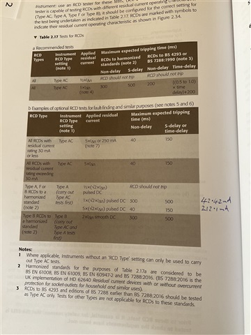

  • The IET Guidance Note Three says the test current for a Type B RCD is 2x I delta n  smooth DC.
    A Megger 1700’s series MFT will not do a 2x I delta n  smooth DC test.
    So, for example, to test a 30mA B-type with DC (not that such a test is a requirement, but if we wanted to) .. we'd have to test with at least 60mA d.c. - which would mean setting the MFT at say 100mA x1 ?

    So some clarification was required in the 2022 GN3 I posted a picture of above.

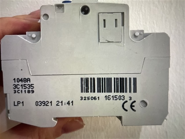

  • There is a note in that Hager Type A RCD testing guidance:
    Devices pro­duced up to July 2019
     ** Please note: This guid­ance DOES NOT ap­ply to CD285U RCCB with a pro­duc­tion date code after 19219 **
    That means if you go to inspect and test an installation with a Hager Type A DP RCD installed around seven years ago, you will need to take the RCD out of the board to read the date code on the back of it,  if you are intending to test in the way that Hager tell you to do it.
