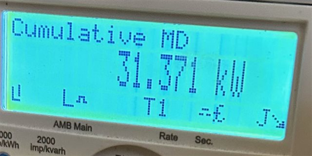

I have a Smart Meter installed.
Since it's out of radio range, it doesn't send readings to the Supplier and the supplier refuses to upgrade the comms module to a 4G one rather than the UHF one, although they have done this for some neighbours after months of complaints.
It's single tariff and there's no export.
It has screens including as follows
+A Value - cumulitive kWh used
Current L1 - real time current (1.465A)
Voltage L1 - real time voltage (238.2V)
Active MD Import - (2.155kW)
Active MD Export  - (0kW)
Rising Demand - (0.283kW)
Cumulative MD - Maximum cumulative demand over 15 or 30 mins (not sure which) (31.371kW)
I've searched online and can't find out what Active MD Import is actually measuring.  It seems a bit low to be maximum demand since there's a 9.5kW shower in use.
Is there a specification somewhere that explains this?

    which mentions "Configurable maximum demand integration period (typically 5, 10, 15, 30 or 60 minutes)" - so I'm guessing the "MD" is only the maximum over the last period (half hour possibly) rather than all-time - so might 2.155kW make sense if you hadn't had the shower running in the half hour (or whatever) before you looked at the readings?
  • Yes, I'd read about configurable periods but still not sure how that relates to the values seen.
    Today's readings are still 2155 and 31.371.  I found another screen that's titled "MD Reset Times" and the value is 18.
    Not sure how to interpret that one though.

    So a peak of 31.371 kW seems unlikely.
    Could it be recording the maximum demand over a certain period, say every hour, and then adding up all the hours over a day?
    I cannot see the benefit in a domestic setting, but in industry, there might be a penalty if a certain value is exceeded.
  • Yes, I can understand the purpose of peak readings in the context of I&C customers where there may be a capacity charging element.
    Clearly 31kW is an implausible domestic load, so presumably it is a number of max demand values added up.  If the numbers were added over a day, I might have expected the value today to have changed.
    I think I need to keep an eye on these values and see if they do change.  Maybe MD is not even configured and these values are left over from meter testing?  Given that it has no comms, it can't remotely be updated or reset.

  • Well, having checked again this morning, the values for "Active MD Import" and "Cumulative NMD" have not changed.
    Yes, we need to raise a formal complaint and go down the Ombudsman route.  Having just entered meter readings to the supplier's website, we've had a bill for just over £600.
    This is not acceptable at all - they really need to get the 'smart' meter working and bill and appropriate amount every month.
    To get to the screens, I pressed both buttons together and then the bottom one to scroll around the screens, but I presume the operation varies between meter types.
