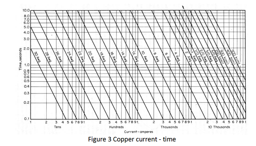

  • OK its not Friday, and I'm holding a mug of warm tea so I'll indulge you.
    Lets assume for argument that when we say the wire is  'at its fusing current' we use Onderdonk's formula  for reaching melting point after exactly one one second.
     this is the US version where A is in circular mils multiply mm² by 1973.5, or if you are in a hurry 2000,  to get circular mils..
    Then look at the answer, mutter I don't believe it and  round it off and say call it 300 amps at one second for 1mm2 to make it easy.
    is that credible ?
    1mm2 is about 17AWG.  Yeah, could be.
    300A is only 1875000000000000000000 electrons going past per second. (1.875 E 21)
    each atom of copper provides 2 electrons, and in a 1m length of copper wire 1mm2 cross-section there are (1000cubic mm ,at 9 mili-gram per cubic mm  that is 9 grams,  and at 64 grams per mol,
    Lemma 1
    Avagadros no is 6.022×1023g/Da where the Dalton is
    1.660×10−27 kg -== mass of one atomic unit.(almost one proton. )
    each copper atom is therefore 1.062E -25 kg.
     so our 1m of 1mm (9 grams) wire has 8.46 E+22 atoms of copper, so
    1.693E+23 Free electrons.
    End Lemma 1
    given 1.693E+23 Free electrons.  and the flux  (1.875 E 21)  each is doing about 1cm/second.
    so in the half cycle period of 10msec, its moved about 100um (times pi/2)  QED
