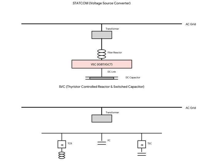

  • My understanding of the 'STATCOM' (Static Synchronous Compensator) unlike an SVC (Static Var Compensator )approach is the electronics looks like most of the invertetr guts of a UPS without the battery bits, but with some large capacitors storing the DC voltage (labelled DC-link in the drawing below, shamelessly nicked from google.)
    These DC capacitors still need to be sized to store rather more than the maximum energy you wish to in-fill if the drop out is multi-cycle and affects all phases. During a drop out that affects only one phase-phase voltage,  or that lasts only for one part of a cycle, there is some chance to refill that reservoir from the other  bits of supply waveform that are not missing, so it can be rather smaller.
    Mike.
  • Yes it makes sense, thanks. So my ETAP transient stability run gives me the MVAr rating and response time needed at the PCC from the recorded dip events, but the DC-link capacitor design itself sits with the vendor. I'll pass on our worst-case symmetric, multi-cycle dip data specifically in the RFQ so they're not sizing the DC-link off an average case.
