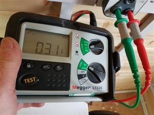

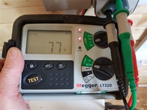

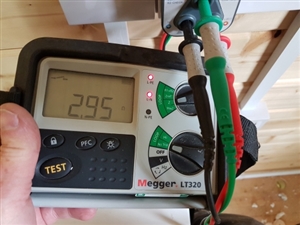

Where an rcd is relied on for fault protection due to high zs it has been suggested to me that the loop between live Conductors needs to be less than the mcb max zs. I can't find anything on this anywhere but he said he had this confirmed by an niceic assessor. Have I got it wrong ?
  • Normally it is assume a MCB will operate when there is a short,  because Zs ha been tested and the MCB will disconnect a earth fault with a CPC that is the same size or smaller than the neutral .
    With a TT installation there is nothing to base that assumption on.
  • Socket circuit in a TT installation protected by a B32/30mA RCBO.
    Disconnection time required by CPD 0.4 seconds rather than 0.2 seconds (Table 41.1), maximum disconnection time by RCD 40 milliseconds.
    Maximum earth fault loop impedance for a B32 MCB to disconnect in 0.4 second 1.37 ohms, maximum earth loop impedance for a 30 mA RCD 1666 ohms.
    Time/current characteristic for B32 RCBP overcurrent characteristic current for time 0.1 sec to 5.0 second.
    So for the RCBO to trip due to a short circuit,  overload or an earth fault it needs to satisfy the requirements above.
    So the RCBO relies on its RCD function to protect against earth faults and it's MCB function to protect against shorts and overload and all the requirements to allow it to function correctly seem to have been met.
    So why isn't the live neutral loop test satisfactory?

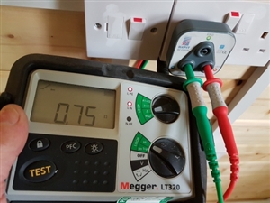

  • The ADS aspect  of that socket is perfectly satisfactory, I would say the volt drop is not great though,  -  if you draw 13A through 0,75 ohms you  lose 17V, which you will notice, and is well outside the recommendations for a public supply.
    the 0.75 ohms and 300A PSSC are consistent with each other to  within rounding errors.

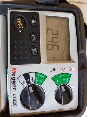

    It's a good job that the voltage is 16 volts above the 230 volts used for calculations to accommodate a potential 17 volts drop.
    From the intake there is around 127 metres of 25mm cables then 15 metres of 4 mm cables, overall it's a long circuit.
    Based on those test results installing a C32/30mA RCBO that requires a loop impedance of 0.68 ohms and a current of 320 amps to operate correctly would seem to be completely unacceptable.
    The RCBO could be reduced to a B20, but that would not really alter anything.
