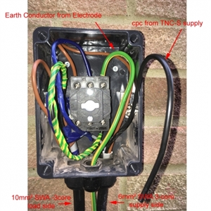

    To give you an idea of the other issues, here is what I found when I opened the isolator...
  • That's beyond belief.
    Whoever connected that up hasn't got the faintest idea of what to do.
  • Rather rough certainly - at least all the incoming wires are on the same side of the isolator, I suppose that is something . Even if  it has done because there is a desire to not expose a bare earthed gland on the outside of the plastic box,  it would have been quite possible to comb and connect the TNC-s  to the armour strands in a block here, although a proper gland at the origin would be much better.
    The use of tape in such an ugly way is not nice, but on its own scarecly a fail, The 2 sizes of SWA are interesting choices.
    As soon as you don't earth the armour, it loses its ADS firing potential and may  as well be T &E behind something giving a bit of mechanical support, like a bit of foil back plasterboard or something. And that really restricts where  you should use it.

    Switched earth
  • unusual certainly, and it is only OK to switch earth when mechanically ganged with the current carrying cores, as it is in this case.
    I agree, it is far from  standard, and rings alarm bells as to if there is something really serious wrong elsewhere.
  • There is an unused earth terminal within the switch enclosure.
  • mapj1:
    I doubt whoever wired it would be trying to claim compliance with 543.3.3.101 No switching device shall be inserted in a protective conductor, except: (ii) a multipole, linked switch in which the protective conductor circuit is not interrupted before the live conductors and is re-established not later than when the live conductors are reconnected.
     In my mind I think it’s a case of they had cables with three conductors and there’s three terminals on each side of the switch so used those rather than the earth terminal provided and that protective conductor is not switched through a switch designed to allow it to make first and break last.
    Andy
  • I don't think that the rotary isolator complies with 543.3.3.101 so can't be used to switch the cpc. In addition there are two spare unswiched terminals within  the enclosure that have not been used.
