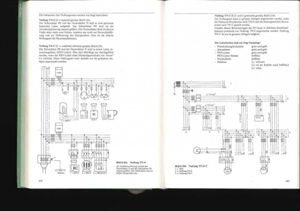

    Seems that in Germany they call the use of a PEN klassische nullung or classic nulling whilst they call the used of separate PE and N conductors moderne nullung or modern nulling where the term nulling can be read as earthing.
    de.wikipedia.org/.../Nullung
    I'm wondering is this related to electrical installations in the former East Germany, where they might have had the former Eastern Block habit of using PEN conductors in final circuits?
  • I believe that the German version is the original, "5 Sicherheitsregeln" is very much a catch phrase. Nulling is grounding the Neutral however the Swiss interpretation is a little different. You are allowed to use a PEN conductor larger than 10mm2 in an installation.
