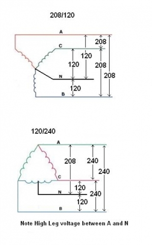

  • I am a little unsure what you are trying to do. Are you trying to re-create an American style supply for testing, but happy to work with 50Hz? If so, then you want a delta connected secondary, with the centre-point of one of the windings earthed. This will give you two phases at 120V to earth, and one phase 208V to earth. The phase to phase voltages should be 240V in all cases.
    Regards,
    Alan.
  • Ah yes, good point, I had briefly forgotten that there are in fact far too many ways of doing 3 phase in the USA.  ?  (let's not even mention the options on 277V L-N / 480v  phase to phase. At least here it is always 3 equal legs, and usually 230V /400 unless it  is 400/690..)
    You mention 208v, so consider the drawings below in one case the phase phase voltage is 208 and in the other it is 240.
    In both cases line marked 'N' in these drawings needs to be earthed.  Only the upper kind, with 3 equal leg voltages can be generated  from UK 3 phase with an auto transformer. With a double wound system the world is your oyster..

    From you saying the primary is 230/400V I assume this is a Yyn transformer. Don’t connect the primary neutral.
    If For a delta secondary only high leg (B phase) will give 120/208V, using the 208V high leg to (A&C) mid point neutral is frowned upon.
    For a Y secondary, as has been said, a grounded star point will give you a TN-S system.
