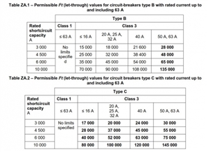

Currently involved in a project where I need to do the energy let through calculations for existing circuit breakers to prove that the increased fault current even though within the breaking capacity of the MCB, damage will not occur to the final circuit cables.
In a nutshell, the following formula must be true I2t<k2S2 . In BS 60898 MCBs the I2t is provided by the manufacturers as these are energy limiting devices.
As these happen to be BS 3871 and in the absence of such data can I get your recommendations? Use a definite trip time of 10ms and plug that in the equation?

  • Let through energy is a bit problematic for breakers - a fuse gets faster as the fault current rises,  and tends towards a constant let- through energy (I squared r times time, but the resistance r is a fixed parameter of the fuse, as is the weight of metal to be raised to melting point to start it breaking)
    For an MCB, although at low currents increasing faut current increases breaking speed, there comes a mechanical limit of how fast the contacts can be separated,and it more or less stops getting faster.
    For this reason, while fuses can be cascaded, and if the thin one blows, the fatter one behind it will not,  for all values of fault currrent, for MCBs no such statement can be made. Indeed it is common to find a random selection of breakers open under fault, and for really high current faults the fuse at the origin fails instead.
    So I2t is actually a function of the prospective fault current, and is either depicted graphically, or listed as spot  values . For mcbs  made to the IEC standards since 1999 or so this is a spec parameter, and guaranteed by design. for earlier devices it isn't
    IF you put in the maximum breaking time of 10ms you will come up with a very large minimum cable requirement,and may well (incorrectly) conclude the cable is not protected.
    It may be cost effective to replace the breakers or back them with a fuse, but first post the make and rating of breaker here - some folk on here have breaker test data going back to mists of time and may be able to advise.

    OK - I think we are getting at cross purposes here, chaps
    The so called instantaneous tripping time of the MCB is 0.1 seconds (100ms)  - it may operate faster, but we don't know how fast
    The definite minimum time to operate is 0.01 seconds (10ms) - it cannot operate any faster
    For the region in between, the only accurate assessment is the energy let through determined by testing and published by the manufacturer (ie the I2t characteristic)
    For an adiabatic assessment, provided you have enough current to drive the operation of the MCB (and that must be true in this case as the concern is of in increased fault level being applied to the MCB) then if you assess the system based on definite minimum time to operate then you have the probable worst case energy let through in the absence of manufacturers data.
    the derived 90,000A2s from above is quite modest - any conductor above 2.0mm2 will handle that OK

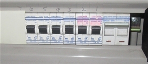

    For information, if these are the old black cased loadmasters to BS 3871, they have an M3 (ie 3kA rating) and for all sizes to 70A, they have A2s values of 10,000, 40,000 and 90,000 for 1kA, 2kA and 3kA fault levels, respectively

    I should also add that if they are slightly more modern Loadmodule or Loadlimiter devices (particularly the latter at 9kA rating) they will have significantly better cut off characteristics at 3kA - something like 10,000A2S on a 10A Type C on a 3kA fault level
