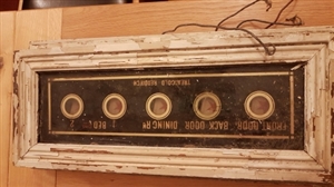

    I just happen to have a Butler Call to hand, it will work better the other way up.

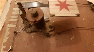

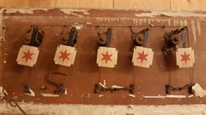

  • Ah, interesting pics. And some 45 years on, I now know what the little bobbins of wire I dismantled as a child came from,as  those fully brass bits for the flag hangers have a distinctive shape I remember puzzling over.
    At the time I was more interested in the fact the wire was insulated with a varnish so thin I could not see it, but once scratched, the copper was revealed. Had I known a bit more about what it was for I might not have been so destructive.
