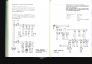

  • Andy, it appears that the Swiss definition of TN-S is slightly different and applies after the main fuse. The attached picture is taken from 'Elektrische Installationen und Apparate by H. R. Ris' (just to avoid any copyright problems ? ). What is described as TN-S is after the main fuse. What is described as TN-C keeps the PEN right to the point of use as long as it is larger than 10mm2. TN-S-C combines both, splitting the neutral and earth when the CSA drops below 10mm2.

  • Der Schutzleite PE wird ab der Anschlussicherung abgefurt..
    (the protective cable PE is lead off separately from the (place of ) the connexion fuses )
    WOW !
    So much for IEC standardization.
    To me that, and more important , to  IEC 60364   would be  TNC-s, namely TNC on the big side, and s on the small side.
    Interessant zu lesen aber.
  • It's not just the Swiss that are confused on that point - it's only with the 18th Ed have we got rid of the phrase "The usual form of TN-C-S is as show, where the supply is TN-C and the arrangement in the installation is TN-S."  from fig 3.9 of BS 7671 (my emphasis).
