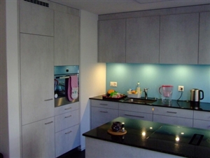

We recently had our kitchen rebuilt and at the same time the distribution box was updated. Here are a few pictures to show a non UK installation. The supply is 3 phase 20A per phase. Lights and sockets are generally 1.5mm2  singles in conduit. Appliance power (2 or 3 phase) is usually cables in conduit. Sockets and lights are on the same circuit for a large room or a number of small rooms. Neutral used to be yellow and is now blue. Phases are red, white and black. Circuits after the switch can be any other colour.
Bare kitchen with first fix cabling
Ready for a light fitting

  • The end result looks pretty

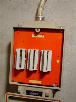

  • Mike,
    The incomer is 27.8mm diameter which I believe is 4x25mm2  with a copper ceander armour (hence the yellow stripe). The main fuse can take up to 160A DIN blade fuses, I guess that 100A is fitted. The outgoing cable is 25.3mm diameter which I believe is 5x25mm2.

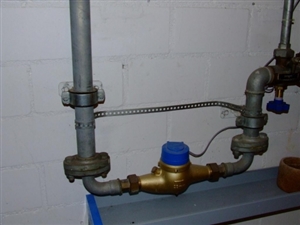

  • Mike, I noticed that the cover on the main fuse was not sealed and cautiously opened it for a look.
    The internal cover is sealed so I couldn't look at the Neutral-Earth connection. What was interesting is that they are 63A fuses and 16mm2 cable for six apartments.
    I haven't located the main bonding to the water system, it may be in the boiler room, but this is the bonding across the wireless linked water meter. No green/yellow or tags in sight.
