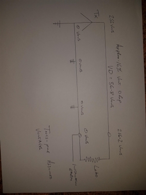

  • My drawing is for worst case N-E voltage.
    TN-S or TT is the worst case,  TNC-S will have the Earthed reference closer to the consumer so will give lower N-E voltage.

  • Dave Newton:
    Maybe this image will help clarify the worst case Neutral voltage you should ever find without a fault.
    So based on that scenario the consumers TNCS-PME earth terminal would be at 18.5 volts.
  • Yes the MET could be up to 18.5v relative to the star point earth back at the substation.
    It could be assumed that there is a 36.8 volt drop just on the phase between the suppliers transformer and their fuse at the customers installation.

  • Sparkingchip:
    The problem with that sketch and the assumptions is that the current has to flow back to the transformer and there has to be some resistance; and even if that resistance is negligible there has to be a volt drop for the neutral current to flow.
  • I am not aware of any DNO installing superconducting Neutrals ? so there will always be some potential difference between the various earths along a PME PEN (except when zero load).
    In the case of a reduced neutral the Line conductors should be sized for the full load on all three phases with an absolute maximum of 37 volt drop.
    If only one phase is being fully loaded then the DNO has an undersized neutral and their design assumption is false in providing a reduced N.
    If the single phase only load is within the capacity of the half sized neutral then their will be a correspondingly lower drop on the one loaded Line.
    If the voltage drop on the neutral + the drop on the line exceeds 37v then the DNO is in breach of ESQCR.  Either because of undervoltage at full load or overvoltage at no load.
    In either case I don't see the N - E voltage at the origin of the installation exceeding this worst case figure of 18.5v.
    In all other situations the N - E voltage will be considerably less.
