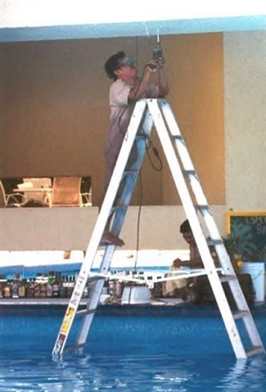

  • As Chris says I've read in reports in the French media that the family had only just bought the house with the intention of renovating it so I'm guessing they were using an extension lead to power the electric shower in the bathroom.
    Unfortunately I think this is one of those 'Oh, it will  be okay, we'll be fine...' decisions that then take a nasty turn.
    Bit like this...

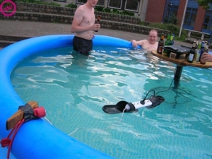

  • Lol... that picture has been doing the circuit for years and is likely to be a set up job to encourage some of the ELF fraternity to get hot under the collar. SImilar to this one

  • Legh Richardson:
    Yes I believe it was outed as a set up... ?
    No one can be that stupid....
    Can they....? ?

    Bit like this...
    Whilst seriously stupid, a bit of humour -- is that known as a floating supply..............
