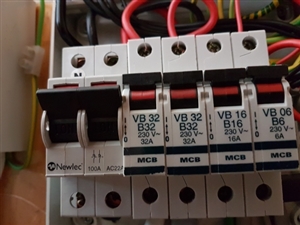

    Last year I asked Rexel  aka Newey and Eyre if they had a Newlec RCD to swap this main switch out, the reply was "Yes we have one in Kings Lynn, the price is £70 plus VAT".
    At that price a new 5 mod consumer unit with a nain switch and three RCBOs was far better value, obviously more labour, there comes a point where things aren't worth saving.
    Andy B.

  • Sparkingchip:
    Not wanting to replace a thirty year old consumer unit that is no longer fit for purpose when a 5-module consumer unit with a main switch and three RCBOs for less than a hundred quid plus labour will bring it up to current standards is just being tight.
    This arrangement is okay, but it’s not a job to be taking photos of to promote your work.
    Andy B.
    Andy, I agree that hardware cost differences are not large.
    As a rough estimate, taking the adopted single RCD solution as the basis for hardware cost;-
    The downstream two, single pole, RCBO option would be about £20 dearer.
    The new C.U. option would be about £35 dearer.
    Although the new C.U. is not significantly dearer from a hardware perspective, it would involve the extensive inspection and testing of the complete installation giving an overall project price increase of about £200.
    Quite significant when considering the original scope.
    There are a number of Registration Body, ESF documents that caution against “over-zealous” coding and unnecessary changing of C.U.
    For similar circumstance in the future, I think I’ll continue to hover between the single RCD and the downstream RCBOs.
    Thanks
