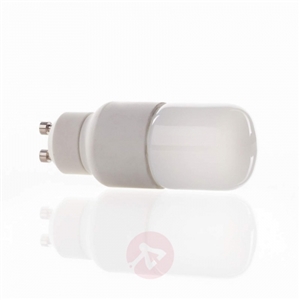

here in the backwoods where I live, I come across lots of old electrical stuff. But yesterday I came upon something very new that I have never seen before. I had to remove a ceiling lighting pendant set in a kitchen of a new house to fit the customer's new light fitting (luminaire). The pendant set comprised a circular round white ceiling rose, a short length of white two core flex, and a lamp holder. This was no ordinary lamp holder such as a B.C. or E.S. type. It was a GU10 type. I have never come across a GU10 lamp holder in a pendant set before. The lamp holder had a special L.E.D. lamp fitted with a GU10 cap, but was like a traditional G.L.S. type lamp in style to give a good all round spread of light output.

  • Got a photo??
    Was it something like this :-
    https://www.lights.co.uk/gu10-4w-led-lamp-in-tube-form.html
  • Hello Crossy,
     the lamp was a full sized pear shaped G.L.S. type. Not a smaller version. It was a modern L.E.D. lamp. It had a GU10 cap.
