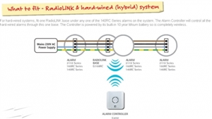

  • I had a moment this week, I wired a Aico carbon monoxide alarm and forgot the wiring terminal configuration is different to the smoke and heat alarms with the neutral in the centre.
    The alarm sounded immediately upon powering it up and required the neutral to be moved to its correct location to silence it.
    A daft moment, but that’s life.
