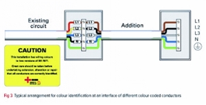

    https://professional-electrician.com/technical/identification-electrical-wiring/
    You would not sleeve the new black conductor blue to use as the neutral and use the new blue as L3 would you?

  • Sparkingchip:
    Andy B
    That's daft!

    I don't know quite how old is meant by "old", but the idea of white for one of the phases seems to have occurred at various times.
    It was around 1970, I think, that the new colours, i.e. brown for live, blue for neutral, green and yellow for earth, were introduced for flexible cords, round about the time also that sizes moved to metric. I wondered at the time why fixed wiring colours were remaining unchanged but nobody seemed able to answer that question.
    I seem to recall at some stage subsequently a proposal that the three phase identification change to brown, white and grey. There seemed some sense in selecting white; it was not used for another purpose, it was bright, like yellow, and there seemed to be a historical link.
    The present use of black as in identifier does seem to beg confusion with the old neutral. Much fixed wiring with the old red and black colours still exists and will continue to be there for a long time, so inevitably there will be cases of new wiring joining older with old colours.
    Can anyone else remember the proposal for white, and why it "gave way" to black?
  • I wondered at the time why fixed wiring colours were remaining unchanged but nobody seemed able to answer that question.
    My guess would be that the change was driven by European trade requirements - manufacturers wanted to be able to sell the same (esp single phase domestic) appliance across Europe (single  market and all that) - each country having its own flex type makes that painful for the production line and distribution. (In those days of course they didn't have to fit an appropriate plug). Fixed installations were much less of a trade issue - they didn't move about so much - and more complicated to solve as it had to address various 3-phase requirements too - so that problem got deferred.
    Probably because most of the continent already used black (or combinations of black and brown) for line (phase) - and white (well officially cream, but usually very white looking in practice) was already established as a functional earth. The continentals really weren't bothered about a third colour - they tended not to preserve phase rotation in wiring - often L1/L2/L3 were brown and two blacks or two browns and one black - that way they could reverse one pair at the motor to ensure correct rotation without anything looking wrong. It was the UK that insisted on a 3rd colour and I gather once you'd eliminated all the colours that had been used for something else in recent history across Europe (the Germans used to use red for earth for example) you were left with only pink or grey. They picked grey.
  • If memory serves (might just be folklore and mee old heed though) , some of the continent used Brown as L1, Black as L2 & also Black as L3, which meant join two Blacks could short 2 phases, then instead of being sensible and adopting the best colours (ours) they did not want to favour or disfavour any single country so they compromised on the colours we get today. A political bodge.
  • Thanks for your take on this, Andy. It accounts for quite a lot.
