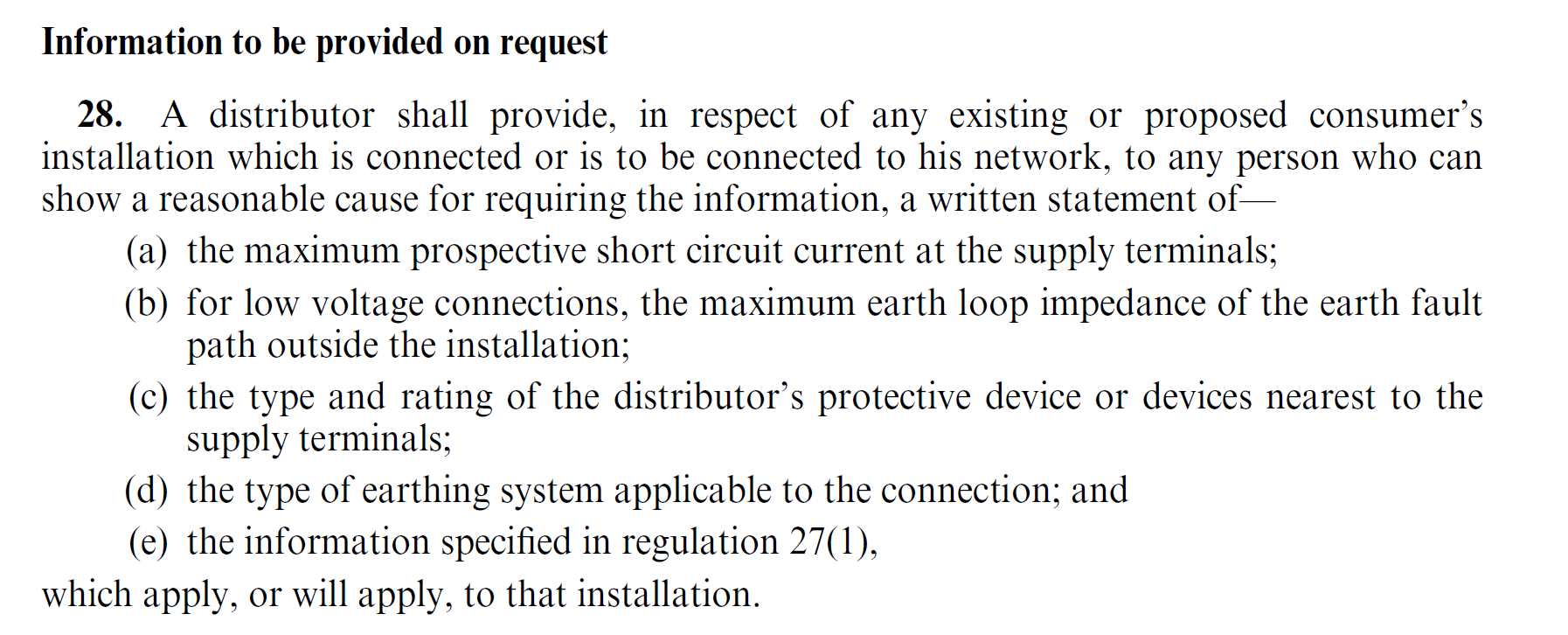

    Contact the DNO and remind them that it is not your responsibility to tell them, it is their statute law duty to tell you, even if they have to send someone to the property to investigate.
    Refer them to ESQCR Reg 28.

  • It sounds like the DNO are trying to duck out of their responsibilities here. Paul is correct, and has posted the statutory law which they have to follow. The law requires them to hold a record of this information, so they can tell you. If for some reason they can’t find it, then they will have to make a site visit to determine it. Call them again, and if they can’t help, remind them of their statutory duties under regulation 28 of the ESQCR. They may not like it, but they do not have a choice.
    Regards,
    Alan.

    However, again as others have said, the DNO is obliged by law to tell you. They may tell you it cannot be PME, and the earth is unofficial, but at least you would know for sure.
