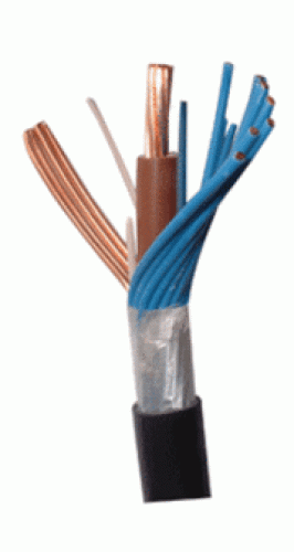

  • For clarification spit con allows a separate neutral and earth (SNE in DNO literature) so presents as TNS. Note that in a building network it is quite likely to still be TNC-s at the origin, so questions like is the main water bond at the origin, and any bonding in the flat supplementary, or is the flat bonding also main bonding, so what size should it be, can cause some dispute. (not as much grief as twin and earth sub-mains though, where the undersize CPC can be a real pain.)
    The construction is the same sort of 'coax cable' as  earthed concentric, but half the outer layer is earth and bare, and the other half is insulated to form the neutral
    Termination requires the neutral strands to be individually stripped and marshalled. Comparing sizes for the same current capacity it is more flexible than SWA, but BS7671 does not consider  it to have an all-encompassing earthed screen or armour so routing  options are a bit less liberal. (again, not as bad as T and E)
    Is the "insulation" adequate insulation?
    Is it half and half?
