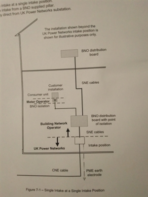

    The boundary is clear, at the outgoing terminals of the intake. "Wiring Regulations" from there. Regards, UKPN

    but a building network, by definition, isn't a consumer's installation.
    Where is this defined Andy?

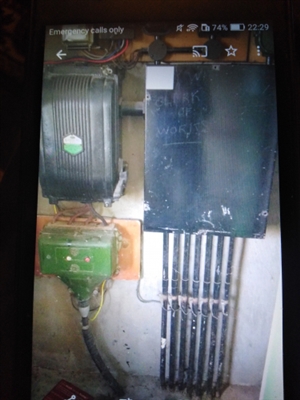

  • I’m sure it used to be more like a blue varnish than actual insulation, which is why I was on the point of quibbling.
    Andy Betteridge
  • The covering was originally a blueish black, (painted) Andy, later insulated. While it was a DNO cable, still millions in use, I cant remember seeing any for "wiring regulations" use. The neutral / earth cores were separated by rubber strands.Perhaps the Wiring regs guys can fill us in. If its in the 18th, (and I don't think it will be), then Martyn is in the clear. Regards UKPNa4a5cb064e47f2dbede49de318fb2e84-huge-img_20190916_222938.jpgThe pic is a 1960s BNO, still in use!
    Regards
    BOD
    I'm working from the The Electricity Safety, Quality and Continuity Regulations which has the following as part of its definitions:
    “consumer” means any person supplied or entitled to be supplied by a supplier but in
    regulations 24, 25 and 26 shall not include, in respect of any supply to meet haulage or
    traction requirements, any person who is an operator of a network within the meaning of
    Part I of the Railways Act 1993(b);
    “consumer’s installation” means the electric lines situated upon the consumer’s side of the
    supply terminals together with any equipment permanently connected or intended to be
    permanently connected thereto on that side;
    “distributor” means a person who owns or operates a network, except for a network where
    that person is an operator of a network within the meaning of Part I of the Railways
    Act 1993;
    “supplier” means a person who contracts to supply electricity to consumers;
    As it's each flat occupier who will have a contract with their own chosen supplier (FlyByNight Energy or whatever) for the supply of electricity, and as the BNO doesn't have a contract or any other entitlement with any supplier for the supply of electricity, it doesn't (to me) seem to fit the definition of a "consumer". More likely it's just a type of "distributor".
    The prohibition on CNE in Regulation 8(4):
    A consumer shall not combine the neutral and protective functions in a single conductor
    in his consumer’s installation.
    only applies to consumers - not to distributors - as far as I can tell.
    As I said, for a new BNO, it's not going to make any difference since the DNO's rules will demand SNE nowadays anyway. But if you're in the situation of dealing with one of the "inherited" BNOs that was originally constructed to distribution standards with CNE throughout, it might be a significant difference.
    Of course there might be some other/later legislation that covers the use of CNE conductors that I'm not aware of...
