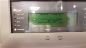

    I assume someone from the fire alarm contractor has come back up to have another go at fixing the alarm system, however the panel now shows a different error message and is now emitting an intermittent audible warning tone that was not present before.
    Apparently the alarm has actually been partially disabled for four weeks and it looks like there is not going to be a quick resolution to the problem.
    Andy Betteridge
  • The panel also says Gent 2020 on it rather than Gent 2019, I assume that is just an indication of the year rather than a software update version?
    Andy Betteridge
