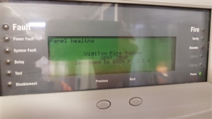

  • My interest in deciphering the fault codes on the panel is to merely decide how much of the fire alarm system is not working.

  • It is a little while since I have worked on a Gent Viglon panel. I don’t recall if the “next” and “previous” buttons will scroll through the faults, but certainly they will do no harm. Unless you open the door, you can’t cause any problems. Next to the main panel, there should be plans that show where the various zones are located, and roughly what they do. From that info, you can work out how much of the system has failed. Following on from my previous comment, I can’t understand why there are no spares around to fix the issue, unless it is a wiring issue.
    After at least four weeks and the fire brigade getting involved, it appears that finally the problem has been found and fixed.
