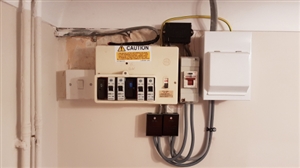

    Now there’s a codge up that may fail scrutiny, but it does have the trimmed cover on the Wylex fuse board.

  • Sparkingchip:
    Andy B.
    My contribution was disconnecting the cable that is lay on top of the fuse board, it amazes me sometimes the lengths some people will go to to avoid replacing a fuse board.
