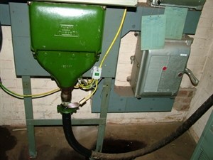

So I may have a job in the offing where I will need to temporally re terminate these 3 cables, the one on the right is only 1m long so I’ll just replace it.
The other two are rising mains from the 1940’s each feeding 20 flats, I believe them to be armoured PILC’s though happy to be corrected, the lead is being used as the earth.
Has anyone re terminated similar and are there any pitfalls that may scupper me?
The re termination will only be temporary whilst the new building network is being installed.89f8b92115c4d5d4e672a2d7771fc855-huge-a8ae4b2d-f17a-4e4e-a594-4469fa0801a0.jpg

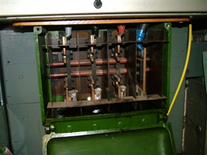

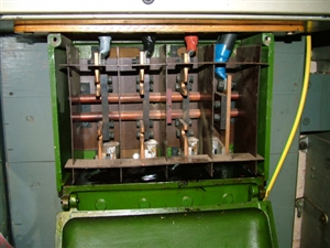

  • For the benefit of those that follow.... attached are views of the inside of that LUCY cutout
    (Pictures taken during a power down - DNO officially pulled the fuses)

  • Alan Capon:
    I can’t remember where the asbestos is in that type of cutout, but it is likely to be in the phase barriers at least. It is conceivable that the DNO will want to cut it out and bag it, without opening it, due to the risk of releasing asbestos fibres in to the atmosphere. The usual method is a “dig and cut” to isolate it outside, then suitable cutters on the cables inside. If it has been obviously interfered with, for example the DNOs seals missing, they may request an asbestos survey of the immediate area first.
    As OMS has stated, I would have expected the SWA to have an outer hessian wrapping, which may have failed and fallen away due to age, rodent attack, or overheating. If overheating was the cause, the insulating papers may be dry and brittle, the impregnating oil having long since dried.
    Regards,
    Alan.
    Hi Alan,
    You are correct, It is the phase flash shields, look a lot like modern paxolin but 1940s.
    The supply is actually above ground outside, maybe erosion but does not look like it was ever buried!
    Do you know what if any responsibility the DNO have for replacing old heads/ removing asbestos sources if requested to do so?
    Thanks
    Martyn
  • OMS:
    Those cables are almost certainly paper insulated lead covered with steel wire armouring. Originally they would almost certainly had hessian covering with an impregnated denso type paste. They look  they've dried through and lost the covering.
    Difficult to judge but they look as if they are terminated (badly) into an enclosure full of bitumen, or to a dry enclosure and the lead sheath has been formed over what is effectively a conduit coupler to act as a gland, and to allow clamping to the sheath for earthing purposes
    Personally, unless you have good experience jointing and terminating PILC, I would leave them well alone, even on a temporary basis.
    Probably easier to replace with a length of wavecon if acceptable to the DNO as a temporary BNO cable or use a length of SWA
    Regards
    OMS
    Hey OMS, long time no see!
    Yes a closer look around does seem to reveal the remnants of hessian, cables rise through the building some 30m I would guess, no outer covering left anywhere that I have seen.
    The terminations above the head is a dry box although with a few ends from old supplies cut off.
    I have not investigated the ‘glanding’ as the Main Neutral is loose, cant be moving anything about.
    You will have correctly guessed PILC’s are not my daily bread, maybe 19 last time I dealt with one.
    If I can get a second supply whilst retaining the existing that makes for a few easier options!
    Cheers
    Martyn

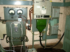

  • Sparkingchip:
    Note the asbestos sticker on the DNO head, they are not going to work on it without throwing a bucket of water over it.
    From experience this will probably mean that a hole is dug outside the building, the supply cable cut and a new PVC cable run in from a joint to a new replacement head. Then a bucket of water can be thrown into the old head prior to it’s removal.
    So nothing is salvageable from outside to building onwards. It seems more sensible to install the new equipment and cables then swap them over in a day.
    I have not done that with more than seven flats and that was a busy day with metering services onsite as well as the DNO and myself, I was there until about half eight in the evening making the final connection as I could not finish until after everyone else had. Then metering services sent a lady the next day to ensure every flat was on the correct meter.
     Andy Betteridge
    Hi Andy, Cheers for your thoughts, Your correct on the Asbestos, there is a sticker on just about everything there! Most of it is for flash shields etc, they are all over the place.
    Most of the meters here are in the individual flats which is good I suppose, that said unless there is 15+ on site there is not a hope in hell of doing a 1 day changeover.
    May look at getting a second supply tapped externally and removing the old one at the end... logistical challenges ahead.
    Thanks
    Martyn
