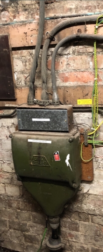

So I may have a job in the offing where I will need to temporally re terminate these 3 cables, the one on the right is only 1m long so I’ll just replace it.
The other two are rising mains from the 1940’s each feeding 20 flats, I believe them to be armoured PILC’s though happy to be corrected, the lead is being used as the earth.
Has anyone re terminated similar and are there any pitfalls that may scupper me?
The re termination will only be temporary whilst the new building network is being installed.89f8b92115c4d5d4e672a2d7771fc855-huge-a8ae4b2d-f17a-4e4e-a594-4469fa0801a0.jpg

  • I would not disturb the old cables in any way, far too much risk of failure.
    Leave the existing cables and the metalwork into which they are connected alone. Use the existing switchfuse, or whatever as a joint box. The existing cable cores are presumably terminated onto some form of terminal in the item illustrated.
    Don't disturb these cable ends or the terminals into which they are connected, but connect new conductors thereto, perhaps by soldering.
    The earth continuity looks a bit dodgy, an upfront time delayed 300ma RCD might be prudent.
    If re terminating the old cables is completely unavoidable, then consider subcontracting this work to the DNO or to whatever subcontractor that the DNO use. They are experienced in this old stuff.

  • The black box looks in good nick for 1940!  Can you get a pic of what is inside? - The "overbraided" earth suggests to me there maybe  no lead  after all - it may be waxed cotton, or some rubber derivative directly under the strands you can see - which in conjunction with the artful use of builders band, rather look like an addition to provide some  CPC functionality at a later date. Or maybe there is some lead, but what we would now call  Zs was a bit high.
    edit - your second post arrived as I posted this. The bigger photo changes it a little - perhaps the braid was original after all. It will need unpicking with very great care.
    I'd suggest you may want a back up plan for what if - even if it is a roll of swa on "sale or return" that hopefully stays in the van and gets returned, but maybe  gets run out of the landing window and back in again lower down the wall if the worst happens and it all suddenly crumbles before your eyes. (The DNO round here have been known to power a house up temporarily from a neigbouri's cut out using  a roll-end length of ABC across 2 front lawns before coming back for the next couple of days to dig a failed joint out.)
    They also carry tapes, sleeves and rubber 'wizard hats' to form 'site applied insulation' when changing cut outs and so forth. There are certainly techniques worth being ready for
    The three cables coming out of the box on top of the head are all the same and 2 core they are lugged L1,L2,L3 left to right in to the head, the one on the right looks different but is just missing the steel outer, the phase lugs appear to have had 2 cores in each at some point in the pas as these are about 6" long and are taped up behind that 'make do' bit of trunking lid.
    The Neutrals from each cable are in to a terminal block with its screws missing so all a bit loose.
    The overbraid as you call it is actually very similar to that of the steel on modern swa, although, at no point is there any outer sheathing.
    The steal is definetely original, it can be seen throughout.
    I may just opt to run a temporary 2c swa to the ground floor 'Ryefield' style boards, bit of a waste though!

  • If they are really lead clad, that is better news.
    Unless it is rubber covered wire clad in lead, which was not really used in that sort of size,  it will be waxed or oiled paper under the lead, which is actually very robust, so long as you do not kink it sharply where the cores come out of the lead sheath, nor wind it up,  or the ends have overheated and lost their 'greaseproofed paper' appearance.
    Section 3.1is the 'how to ' for safely opening up paper insulated lead clad. Note the use of binding with a wire or a hose clip to retain the cable integrity during cutting, and to give a clean end stop to the 'peeling' process.

  • Note the asbestos sticker on the DNO head, they are not going to work on it without throwing a bucket of water over it.
    From experience this will probably mean that a hole is dug outside the building, the supply cable cut and a new PVC cable run in from a joint to a new replacement head. Then a bucket of water can be thrown into the old head prior to it’s removal.
    So nothing is salvageable from outside to building onwards. It seems more sensible to install the new equipment and cables then swap them over in a day.

    Those cables are almost certainly paper insulated lead covered with steel wire armouring. Originally they would almost certainly had hessian covering with an impregnated denso type paste. They look like they've dried through and lost the covering.
    Difficult to judge but they look as if they are terminated (badly) into an enclosure full of bitumen, or to a dry enclosure and the lead sheath has been formed over what is effectively a conduit coupler to act as a gland, and to allow clamping to the sheath for earthing purposes
    Personally, unless you have good experience jointing and terminating PILC, I would leave them well alone, even on a temporary basis.
    Probably easier to replace with a length of wavecon if acceptable to the DNO as a temporary BNO cable or use a length of SWA

  • I can’t remember where the asbestos is in that type of cutout, but it is likely to be in the phase barriers at least. It is conceivable that the DNO will want to cut it out and bag it, without opening it, due to the risk of releasing asbestos fibres in to the atmosphere. The usual method is a “dig and cut” to isolate it outside, then suitable cutters on the cables inside. If it has been obviously interfered with, for example the DNOs seals missing, they may request an asbestos survey of the immediate area first.
    As OMS has stated, I would have expected the SWA to have an outer hessian wrapping, which may have failed and fallen away due to age, rodent attack, or overheating. If overheating was the cause, the insulating papers may be dry and brittle, the impregnating oil having long since dried.
