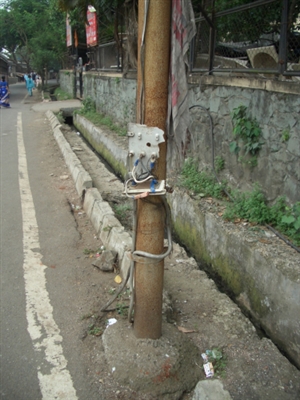

  • India is not much better.0e52ff7ab47df33756b925f374e7a37f-huge-cimg1232.jpg
