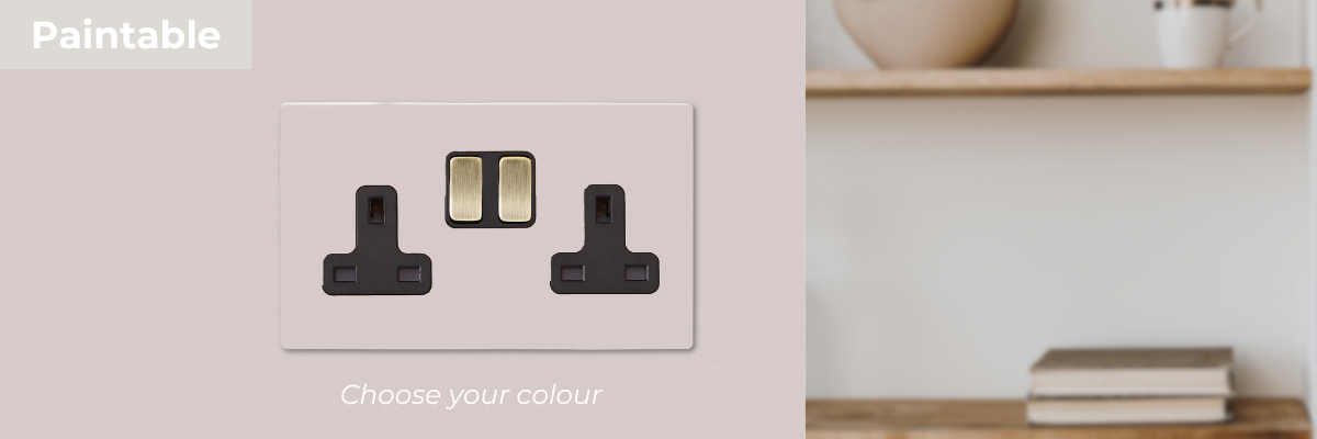

    https://www.hamilton-litestat.com/decorative-wiring-accessories/paintable/#.XbHQ0cqp6f0
    Those fittings have a removable front plate that can be painted with an insert around the actual socket and switches that is intended to be left unpainted.
    Painting ordinary plastic fittings is almost certainly foolish and potentially dangerous, also a good paint finish that will stand the test of time and usage is almost certainly unachievable.
    The only fittings I have ever seen with a acceptable paint finish are the old fashioned industrial malleable iron fittings.
