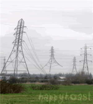

    I was sent this image once, to illustrate a problem with wind on long wire spans.
    I think it may have been edited. Click it and see what you think..
