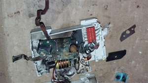

    That is where the entertainment begins. In theory an mcb used at or below its rated fault current will trip on a fault as everyone expects every time. If the mcb is used above it’s rated current, it may trip correctly, or it may fail catastrophically. The idea of the conditional “rated assembly” is that if the device fails attempting to trip, the enclosure will contain all the bits, including the explosion until the upstream protective device (the supplier’s cutout for example) clears the fault. If the type-tested assembly fails, then the manufacturer may be liable. If they can then prove the presence of another manufacturer’s device or a device of theirs that was not included in the testing was fitted, then it is likely they have no liability.
    My reason for not giving a definite response, is that a catastrophic failure of a type-tested assembly would have to be examined in a court of law for an absolute judgement.
