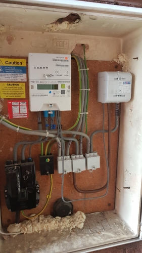

    The job I am just leaving.
    Go on, figure the wiring out.
