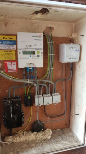

    Thanks. I wonder why no low current switch output from a Smart meter to switch an external contactor just like my old dumb pre-payment meter? I already had the contactor.
    The job I am just leaving.
    Go on, figure the wiring out.
    Andy B
    The meter is switching the neutral to the contactor.
  • Go on, figure the wiring out.
    Looks to me like a simple single phase supply with a meter that has a some volt-free contacts that close when a certain tariff is in force (probably "off peak") - the proteus box at the top right contains a contactor and a 1A(?) fuse - which supplies the contactor coil and is switched (in its neutral) by the meter (eventually ending back in the cut-out N's block). So the the mid-right tails will supply the 24h CU and the left hand ones the off-peak CU.
    I'm not sure about the T&E at the bottom and judging by the JB and expanding foam, I probably don't want to know...
  • You would get a slap on the wrist for switching the neutral, wouldn’t you? ?
  • Sparkingchip:
    Not if you switch line as well (preferably break line before neutral, etc.) 132.14; or it's a lamp control circuit 463.1.2 but Sparkingchip is correct if the switch is in the neutral conductor alone 530.3.3.

  • It was allways the way to switch the neutral on a 3 phase supply, i may still have an (rec) official wiring diagram somewhere.
  • It does make switching the E7 supply contactor very simple and as said above, a different set of rules apply.
    Andy B.

    Yea indeed. My supplier wanted to fit a REC4 switch. I declined.
  • Sparkingchip:
    Andy B.
    Otherwise the supplier could make the volt-free switch available to switch equipment within the customers installation, but that would create all sorts of issues.
    Andy B.
