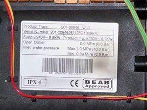

  • Shower rating label.
  • mapj1:
    My experience  of showers that change temperature in time with the washing machine fill cycle is that they are  constant resistance loads, and outlet temperature is set by adjusting the flow rate, as that affects the time that any given body of water is in contact with the heater.
    Or in simple plumbing terms, if Mrs P runs a bath, the "voltage" of the hot water supply falls, but the "resistance" being constant, the flow falls and I get a cold shower. That's without any electrics. ??

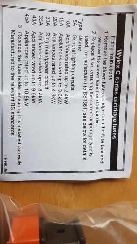

    Manufacturer's instructions.
    Andy B.
