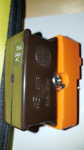

  • I have a pre-used 35-amp cartridge fuse in a Wylex 45-amp fuse holder with a orange base on the side of the dashboard in my van. They were made for 7.5 kW electric showers as the showers were a bit too beefy for a 30-amp fuse or fuse wire.
    Andy B.
    A Wylex 45-amp fuse holder with a 35-amp cartridge fuse.
    Andy B
  • Apparently the local branch of Wickes has 35-amp fuses in stock.
    So not much of a rarity, they should be on the shelf with 40 and 45-amp cartridge fuses as well.
