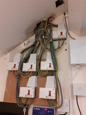

We have a block of flats completed in 2017 that have supplies to individual flats in insulated twin and earth.
These cables are fed from a switch fuse and then into a ceiling disappearing into the building fabric.
I no longer carry electrical regs books (Approved sparks but fire specialist) but I did flag up the poor way these cables were installed and questioned if they required a RCD as they were not in metal conduit of armoured cables as I normally see.
Was it not a requirement in a 2015 amendment that all cables such as this were protected/RCD?
Many thanks for taking the time to read.
Paul.

  • OK, I'm  now near a copy of the 18th, and of course the actual thing is a bit wordy, so apologies for the block quote but '202  is clearly only for cables less than 50mm from surface, anything more than 50mm deep is out of scope and can be routed how you like -
    however '203 which is for partition walls made with metal framework, sensibly does not have thick walls as a protection, as the wall will bring any voltage from a buried fault to the surface,and such partitions often have sharp metal edges internally that can snag a cable.
    Hope this helps.

    This is a brand new installation  the tails go through the wall to the meters, the t&e go to mains boards on the walls of each flat.
    It's the worst new install I have ever seen!1727f1fd02063d4d2eeb8c2a6496b970-huge-20200116_092423.jpg
  • It may be electrically sound and not actually break any  regs but it certainly earns no prizes for beauty or quality of workmanship.
    Also things that are that rough on the surface make you wonder about the quality of all the bits you cannot see, have they remembered fire stopping  in ceilings and and holes in joists in the right places  for example?
  • Untidy, so not good workmanship. I would check all the tails screws in each switchfuse, because I bet they are not tight, particularly as the ties were probably added after closing up! What does the EIC say, who is responsible, no reason not to publish it!
  • It would be usual to have the switch fuses in the same room as the meters, and certainly within 3m cable length of them. Where are the meters?

    It's a horror installation,  the other side of the wall is the main intake, all tails are bunched and hanging in cable ties, supplier cable laying on the floor! It just under 3m length on the tails.
    The switch fuses have had the covers so badly cut you can get your finger in there. The board they are fixed to is falling off the wall. I honestly thought they were temporary supplies when I saw this!
    the earth cables are jointed with a floating connector block in the switch fuse covers, these look to be rated at no more then 30A.
    We may end up going the legal route as the automatic fire smoke vents fitted and fire shutter are illegal and the main contractor is denying liability so I'll keep their details anonymous for now. It's a national home builder though....
